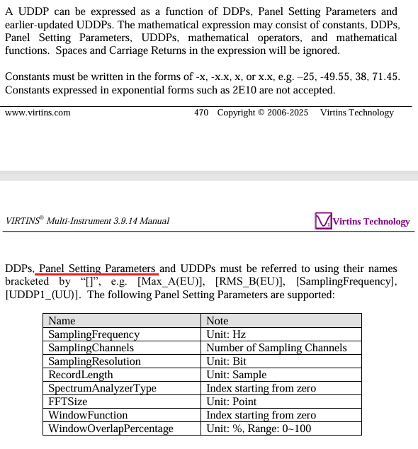

17. DDP for Sampling rate, FFT size, Number of points, Number of channels

About 17 and 18, I think you know the answer.
To compute bin start and end, we need Round function, Sampling frequency and FFT size.
Already provided.
