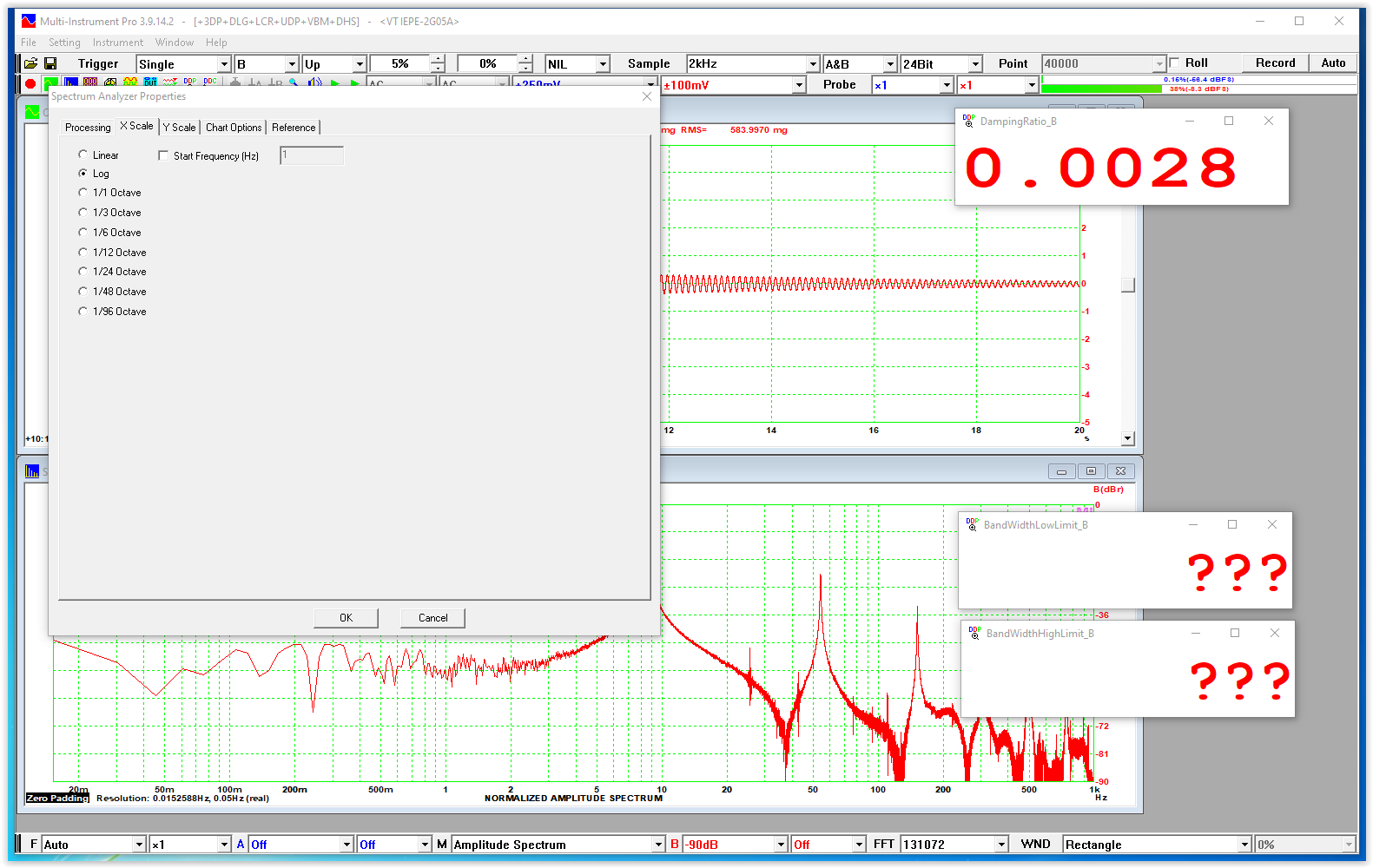

I encounter the following issue for bandwidth (-3 dB) measurement.
If the X Scale is set to Log initially, the DDP will not show the bandwidth information as shown in the picture below.
no bandwidth display

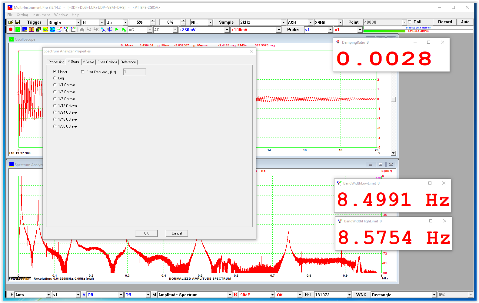

I have to use linear for X Scale to see the bandwidth data.
bandwidth available

Postby VirtinsTech » Sat Jun 21, 2025 2:27 am
Thank you very much for the bug report. We will fix it in the next software release.
