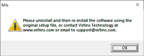

Postby RJA4000 » Sun Sep 29, 2019 9:45 pm
Thanks for your detailed answer.
First, about the manual start:
I realized that I always tried to start a second instance by clicking on the taskbar MI Icon.
Then I always get the following message:
2019-09-29 15_28_53-MIs.png (36.12 KiB) Viewed 86984 times
But when I use the desktop Icon, all works well.

Postby VirtinsTech » Tue Oct 01, 2019 10:58 pm
This error message "Please uninstall and then re-install the software using the original setup file, or contact Virtins Technology at...." will pop up if the configuration file scins.cfg is somehow incompatible with the current MI version. If it pops up for the second instance only, then an incompatible configuration file scins1.cfg exists somewhere. Deleting that file will allow the software to create a new and compatible scins1.cfg automatically after launching the second instance.
