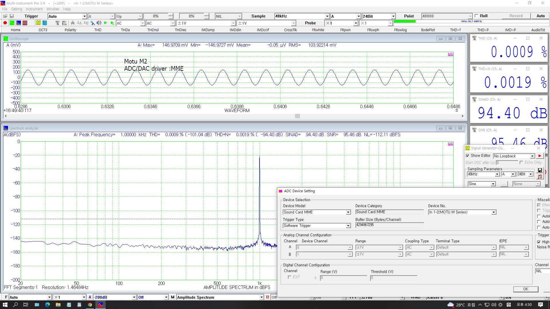

Attached pic1 : Motu M2 Spectrum Analyzer with MME driver.
Not yet sweet-spot, but seems normal.

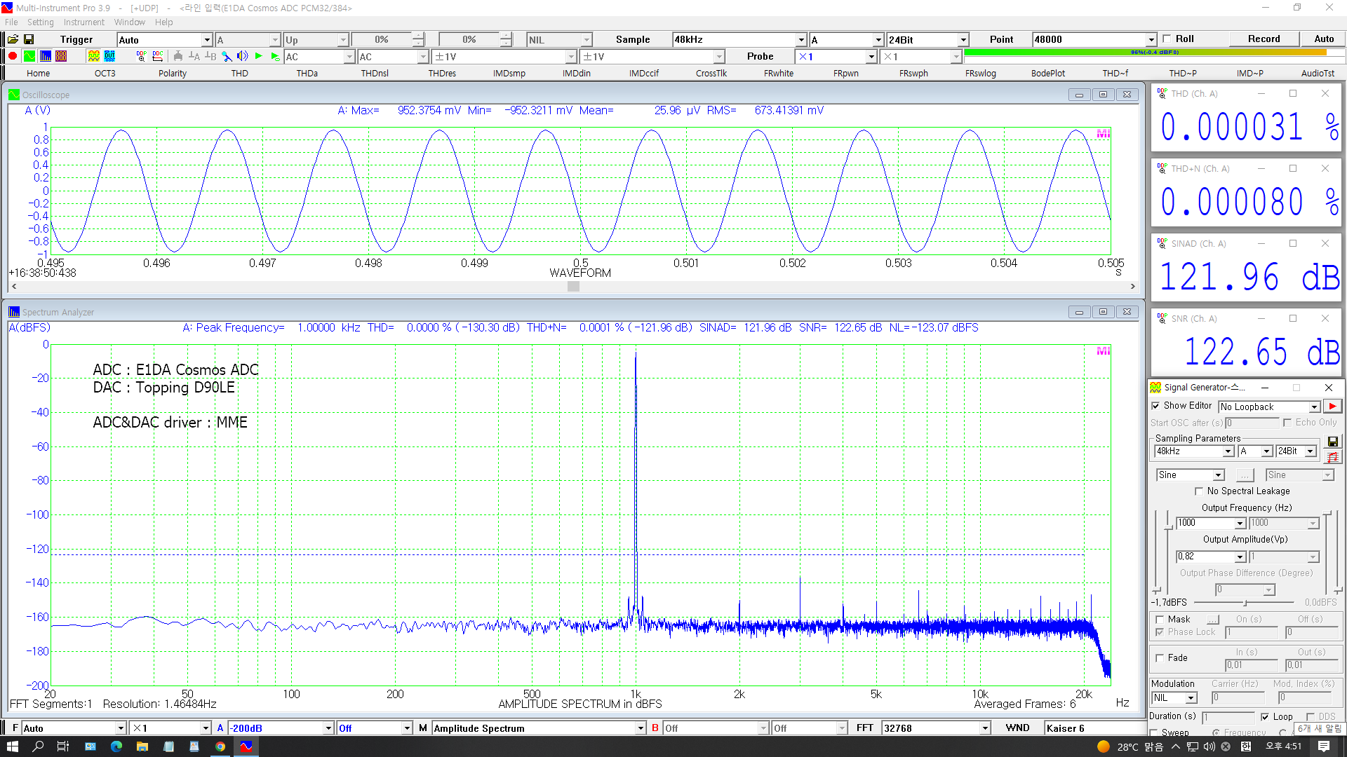

Attached pic1: Cosmos ADC+Topping D90EL with MME driver
Approached nearly to sweet-spot, and I expected that if I could select ASIO driver, results would be more precise.

It does not look like a discontinuity between buffers. It maybe caused by something else.
