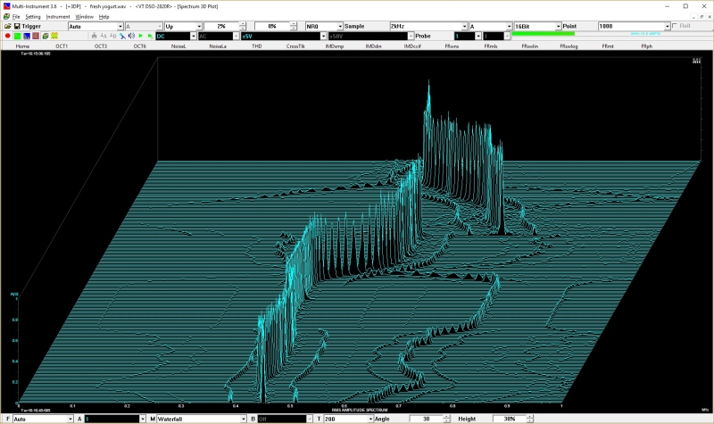

Can you record a live session or playback of a portion of the data seen on the screen to a .mov, .avi, .mp4, file for example, to be played back at a presentation?

You can use a screen recorder software such as Camtasia (free trial) to record what is being displayed on the screen.
You can also record a long wave file to the hard disk using MI's "Record" button at the upper right corner of the screen. Then select a proper oscilloscope frame width in MI, go to [File]>[Open frame by frame] to open the long wave file frame by frame. Set the analysis parameters in the Spectrum Analyzer and Spectrum 3D Plot properly, and click "Frame Auto Scroll" button in the Long Wave File Navigation Toolbar to re-generate the 3D water fall plot on the spot.
