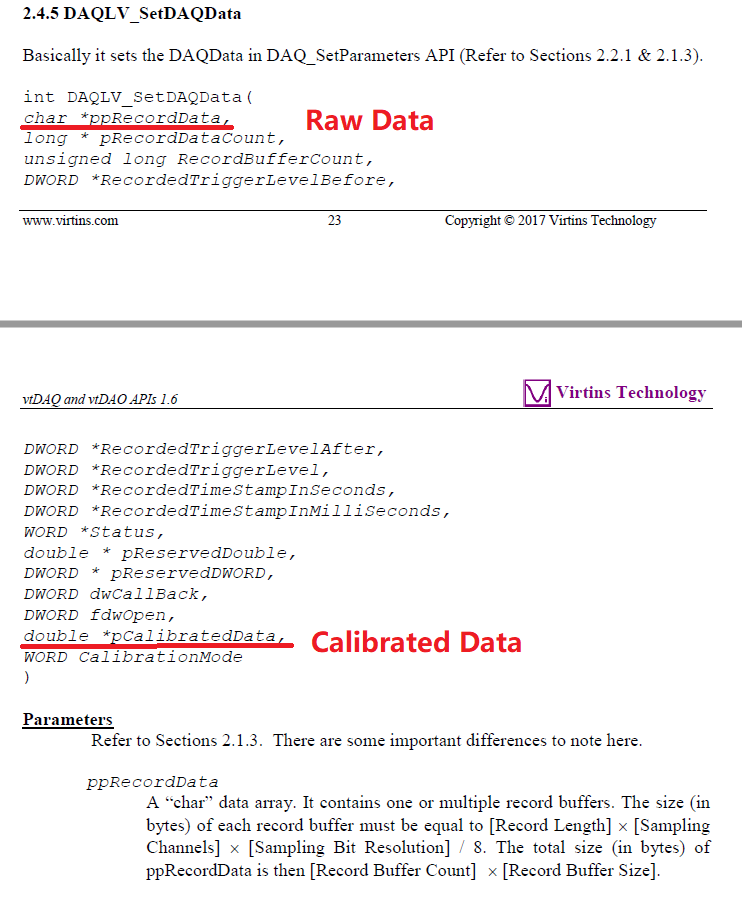

The pointer to raw data array and the pointer to calibrated data array can be passed to vtDAQLV.dll through DAQLV_SetDAQData API (see figure below, refer also to Section 2.4.5 of the vtDAQ and vtDAO API document).
If the calibrated data are not needed, let CalibrationMode=0 and pCalibratedData=NULL.
