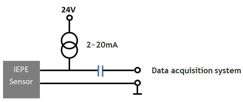

CA-YD-185 is an IEPE accelerometer. It requires a 24V 4mA excitation power supply as shown below. You can use an external 24V 4mA constant current power supply to drive an IEPE sensor, and feed its output to an AC coupled data acquisition system such as a sound card or a VT USB DSO. You can also use our product VT IEPE-2G05 which already has built-in 24V 4mA power supplies to excite the IEPE sensors.

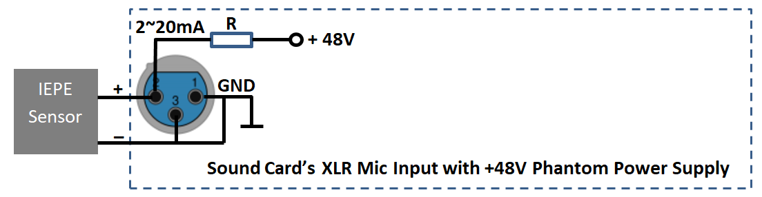

Some sound cards have XLR mic inputs with built-in 48V phantom power supplies. On the 48V pin, there is an internal current limiting resistor in series which would limit the current to be less than 20mA even if it is shorted to GND. If the IEPE sensor is able to withstand 48V, then an easy and workable solution (admittedly not very professional) is available as follows. In this way, the external 24V 4mA constant current power supply is not needed.

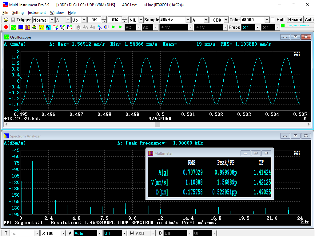

CA-YD-160 is an accelerometer. It does not measure displacement directly. In Multi-Instrument, an acceleration signal can be converted to a velocity signal and then a displacement signal through single integration and double integration. The following shows a simulated 1kHz sinewave with a peak acceleration of 1 g. It can be seen the measured peak velocity is 1.57 mm/s, and the measured peak-to-peak displacement is 0.524 um.
