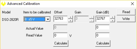

If the problem still exists, could you please provide the following screenshots for further diagnosis:
1.[Setting]>[Calibration]
2.[Setting]>[Calibration]>"Advanced">"A: +/- 2V"
3.[Setting]>[Calibration]>"Advanced">"B: +/- 5V"

Postby VirtinsTech » Tue May 09, 2017 5:11 pm
The chances for two relays to fail at the same time is very low, unless somehow the power from the USB port is not enough. You can try it on another computer or use another USB cable. A relay click sound should also be heard when switching from a sampling rate of 200MHz to a sampling rate of below 200MHz.
Also, under Gain(dB) column of the screenshots, "32767" is displayed for both cases. This is also a little strange as the number does not seems to be the ones set by the factory. Did you try to re-calibrate it by yourself?

Postby Squatch » Thu May 11, 2017 12:26 am
Using the example on page 21 of the VTDSO-2820R manual rev1.1.
Re-calibration of channel A through all the voltage ranges was successful.
When calibrating channel B erratic readings started and the scope trace was all over the screen when the screen froze with an error. “Transfer error!”
After doing more testing it was found that the USB connector may be at the root of the problem. Some masking tape was applied to the cable connector at the input and lashed it under the DSO chassis and tension tightly. The unit is stable over time and calibrations can be done. A second cable was tried and we had to tape it too. What would you suggest we do?
