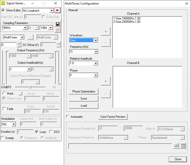

When the device has only one analog output channel, only one channel will be activated on the signal generator panel (see picture below). MultiTone is supported only under streaming mode (non-DDS), therefore the maximum sampling rate sustainable is about 5MHz (16 bits, single channel) without the oscilloscope running.

Thanks for the reply that helps. I am not sure what you mean when you said while the scope in not running. What happens when the scope is running? Can I not use that signal to my DUT and feed it back to the scope to see the difference? would the sampling rate be much lower if the scope is running?

I guess what you meant was no loopback setting.

Streaming mode uses the USB bandwidth to stream data. The current VT DSOs support USB 2.0 high speed which is about 480 Mbits/s. Our tests show that the max. sustainable sampling rate for either the oscilloscope (for input) or the signal generator (for output) is about 10MHz @ 8 bits, single channel. If both the Oscilloscope and the signal generator are running, the max. sampling rate will have to be at least halved.

On the other hand, it is possible to define the waveform of a multitone using a CSV file (see Section 4.3.1.9.1 Waveform Library File (*.wfl) of the software manual) and then use the DDS mode of the signal generator of the VT DSO to generate it. In this way, the limitation of the streaming mode is avoided.
