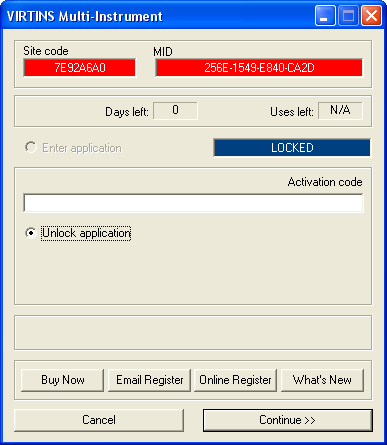

After successful installation of the software, you should run it in order to obtain the Site code and MID (Machine ID) values for your computer. We need these codes to calculate the Activation Code (softkey) for you. When you launch the trial software, an activation dialog box will pop-up. The Site Code and MID of your computer will be displayed in this dialog box.
You can use the Activation Code Request Form or simply click the "Email Register" button in the above dialog to submit your Site Code and MID.

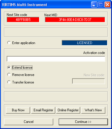

After you purchase an upgrade package, you should submit the Next Site code and the Next MID values from the LICENSED computer to us, we will generate the corresponding new Activation Code and send it to you afterwards. You can then use the new Activation Code to extend your license.
To obtain the Next Site code and the Next MID of your licensed computer, turn on the "Scroll Lock" key (or press and hold the "Shift" key) on your keyboard and then run the software, the activation dialog box will be displayed. Choose "Extend License", the Next Site code and the Next MID will be displayed.
To extend the license, turn on the "Scroll Lock" key (or press and hold the "Shift" key) on your keyboard and then run the software, the activation dialog box will be displayed. Choose "Extend License" and enter the newly issued "Activation Code" in the "Activation Code" field, and press "Continue >>" button.
